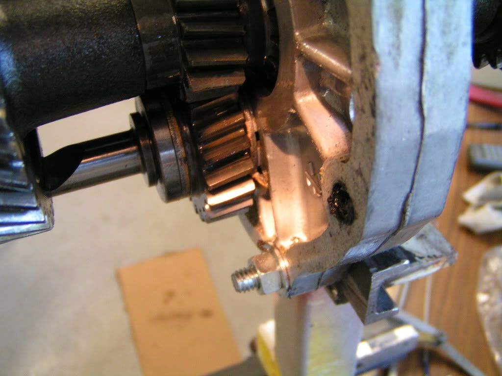

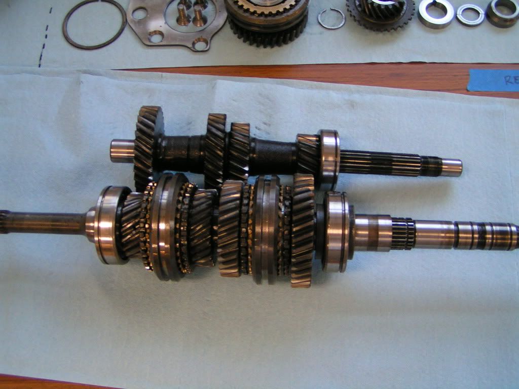

My method wasn't very scientific so that ratio seemed like a 1 to 1... pic's of trans.
this shows the 5th / rev. gearing, only one syncro on the shaft for 5th, reverse gears lock to idler gear
Rev idler gear
1st thru 4th gear clusters on main shaft - all have syncros & move unless syncro is slid over & locked

With the box apart it is even easier to get the exact ratio. The only gearbox's that have 1:1 5th will be the ones that 5th is the input and drop gear ratio's. The one pictured above is a 60A with 5th and reverse being together.
Posted on: 2009/6/26 23:30
Re: 5 speed question
In other words, if it has a gear for 5th, it is not "5th direct" transmission.
In the regular 4-speeds, there is no mechanical gear for 4th, instead the input shaft locks to the output shaft (direct drive). The counter gear has 1,2,and 3 on it.
In 60 and 63 five speeds, there is a mechanical 5th gear. Fourth is direct, fifth goes through a gear that meshes with the countergear. The counter gear has 1,2,3,and 5.
In 56 series 5-speed, fifth is "direct". There is no counter gear for fifth. When in fifth the other four gears spin freely on the main shaft. Counter gear has 1,2,3 and 4th.
