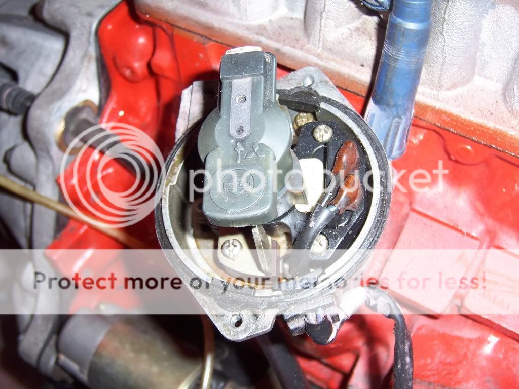

Re: electrical problems no spark - can someone tell me what model dissy this is
2007/11/10 8:16
From Perth WA Australia
Posts: 93
Fuses are good. Not sure what type of distributor it is, any suggestions, it has a blue and black wire running off it. I take it they should be pos and neg connections on the coil and if the coil has power to it, it should have spark at the plugs or the coil is not working. Not sure what the readings should be on the coil for a bench test.

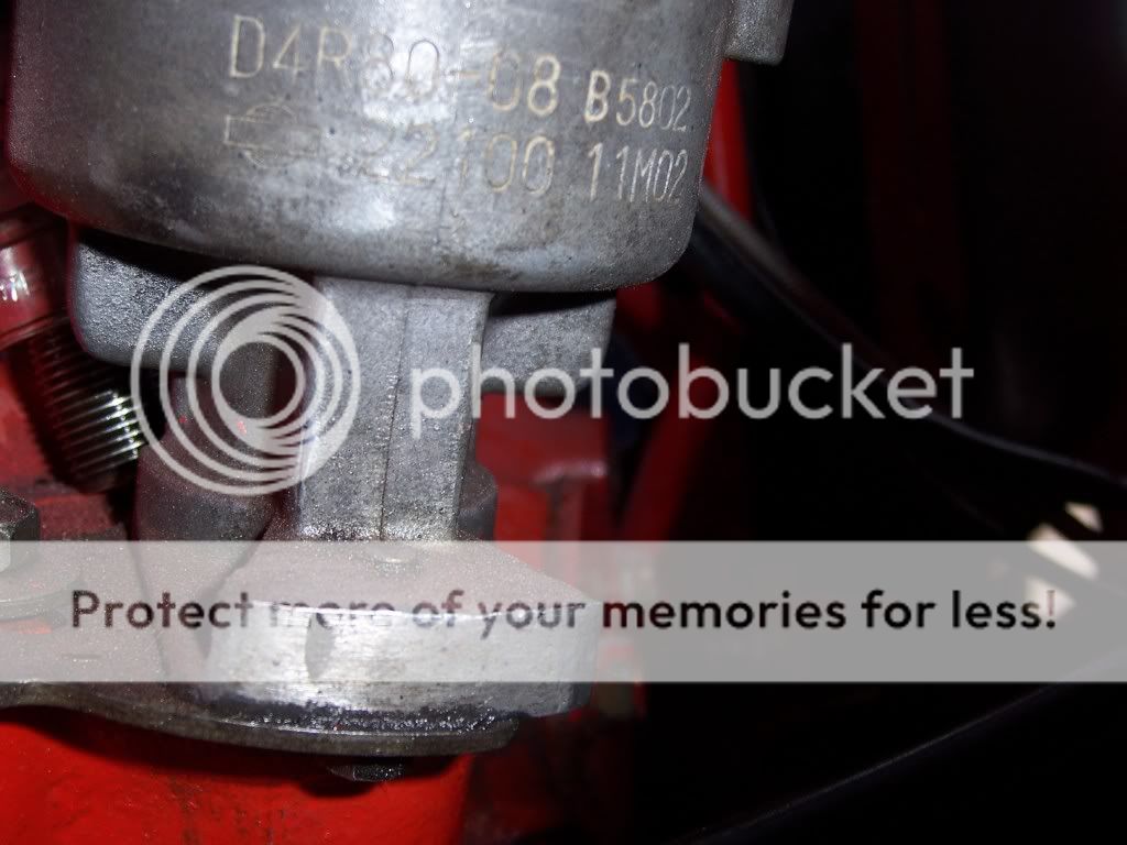

2007/11/10 8:16
Posts: 93
can someone tell me what model dissy this is. Obviously auto electrical stuff is not my bag
Posted on: 2009/9/16 11:23
2006/5/5 4:46
From perth airport
Posts: 5432
looks like the n12/13 pulsur dizzy :)
