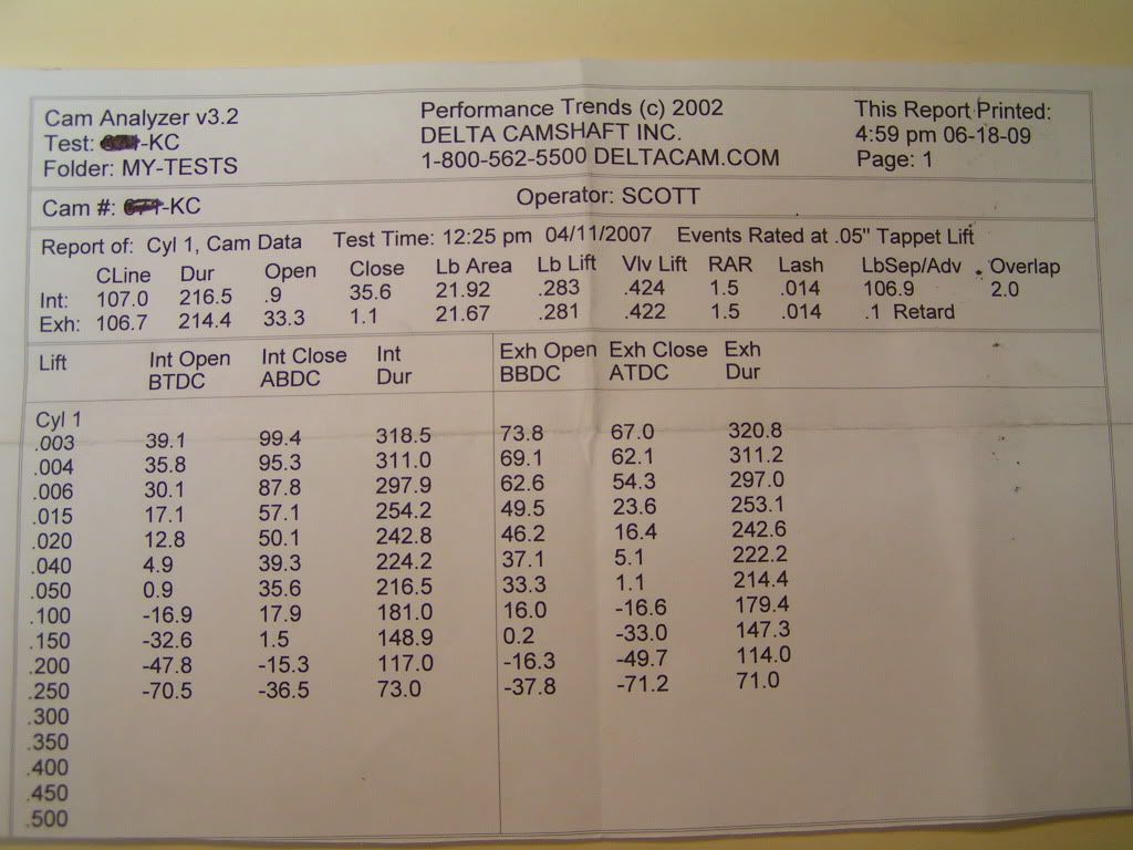

hey tom, I dont know if you remember asking for the cam spec's a while back on my A15 or not but here they are - sorry it took so long. This is the Delta cam regrind out of Tacoma,WA.

Ed thanks for the cam sheet.
