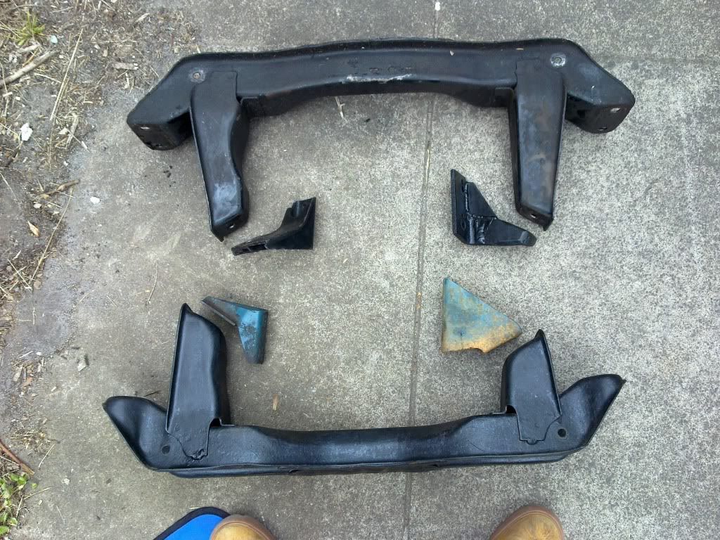

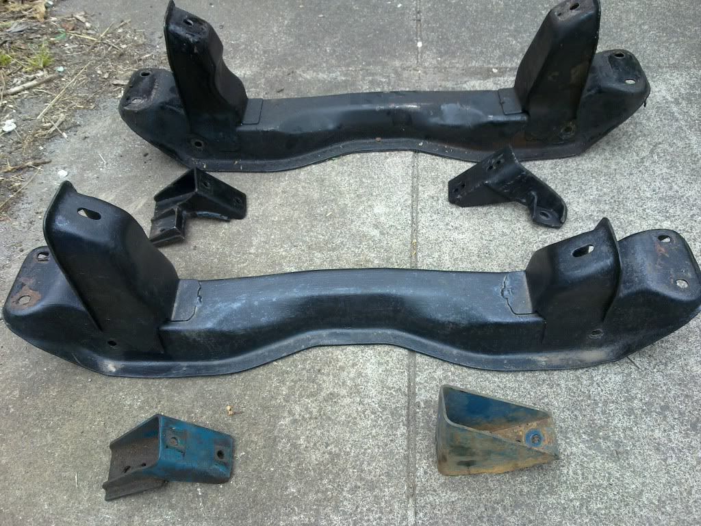

Whilst I had them handy, Detailed cross member comparison.

Excellent photos. The B110 motors mounts, are they stock or swap mounts for A14?
Posted on: 2010/1/13 6:04
Re: Whilst I had them handy, Detailed cross member comparison.
2008/2/17 3:04
From Melbourne, Oz
Posts: 2029
The right hand one (on the left in the pics) is a standard one with a plate welded on tho extend the mount forward. the other one is one I made to clear the extractors..
and they are the standard ones for the late cross member.

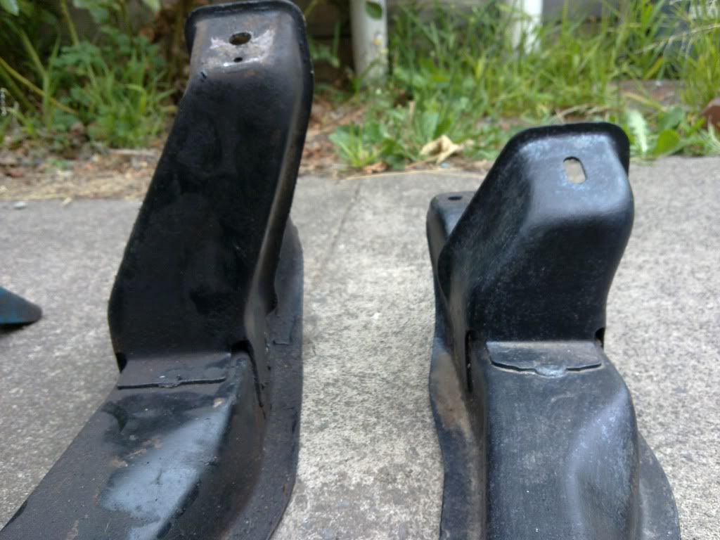

I forgot to take a beffor shot of the mounts in the car, but this shows the miss alighnment.

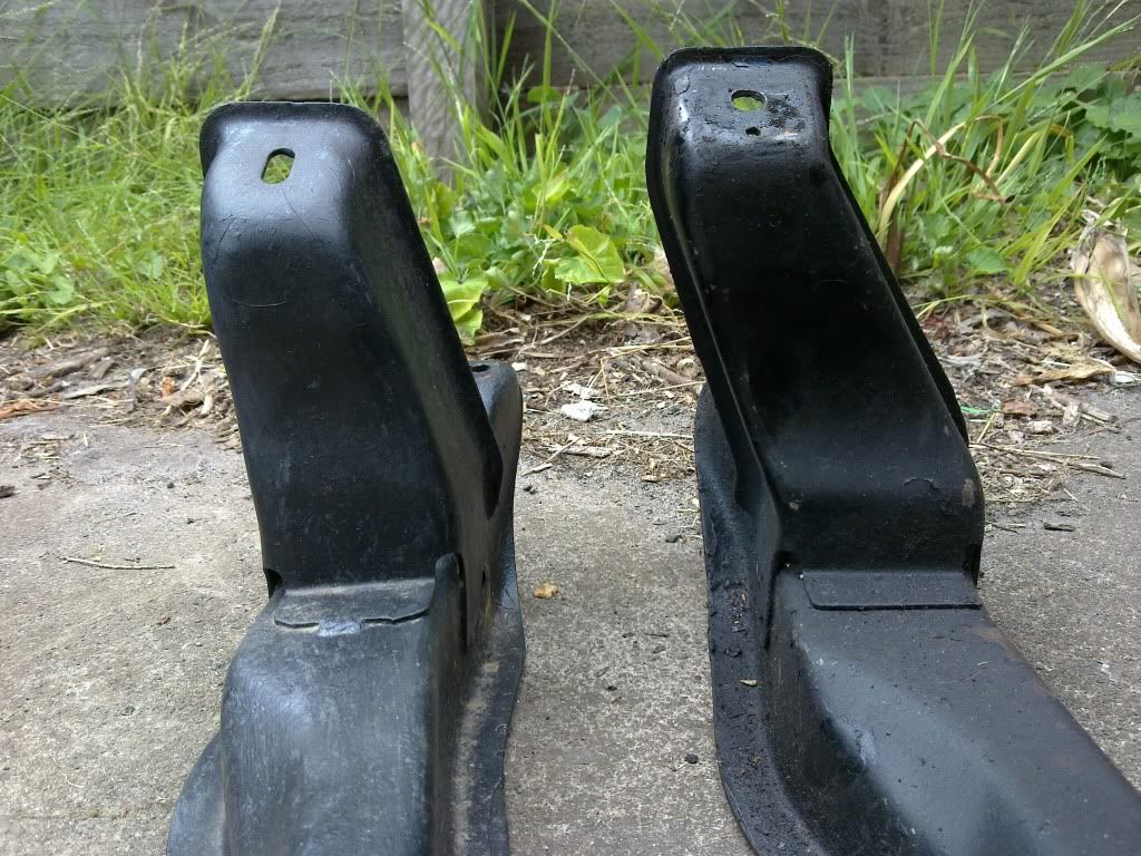

And this is after.
