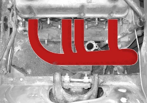

Right Im not after the ultimate performance for one of my K projects
so Im aiming for better than standard in looks and performance :)
The inlet is going to go up into 90 degree bends and a small plenum for
a single 2 inch SU carburettor or 1.75 stromberg sitting on a 45 degree
angle with a velocity stack all shined up. Either on the same side or
curving over to the other side to increase torque down low on the asthmatic
A10 with its 59mm stroke.
Here is so far what Im thinking but in stainless steel tubing meeting
bent at the end to meet the rest of the exhaust.
The first 2 pics are the inspiration...
jpg  rodex2.jpg (18.59 KB)
737_4c21af8f91d25.jpg 359X193 px
jpg  rodex.jpg (189.27 KB)
737_4c21af9ea395f.jpg 954X524 px
jpg  b10xtra2.JPG (191.68 KB)
737_4c21b591bd638.jpg 750X529 px
Posted on: 2010/6/23 7:52
Edited by D on 2010/6/23 8:19:10
Edited by D on 2010/6/23 8:19:56
Edited by D on 2010/6/23 8:29:43

Right on the money Wurz, the only difference is the middle pipes need separation
to help with flow a tad, as you can see in the pic of the Austin the middle pipe
doesnt get hot enough to be discoloured. The cooler the pipes the less efficiency.
Id love to use to use the back of the engine somehow with a shaft from the front to
spin a supercharger. So the inlet is at the front using the mitsubishi style supercharger.
The pic below is how the supercharger will face if looking up below the passenger side
The only biggie is how to spin it so the inlet faces the front grille.
It would look so cool have a single SU, alloy rocker cover and supercharger all polished
and the rod exhaust also acting as support with insulation in between.
