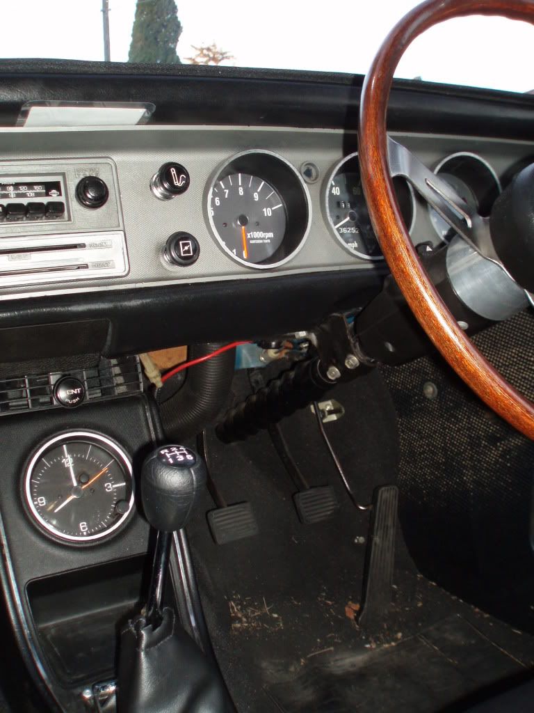

The factory Datsun 1200 tachometer is wired differently than most tachos because it uses induction signal.
•B - ground - to back of Instrument Cluster
•YR - IG power - to back of Instrument Cluster
•RG - lights (two lights, two wires. Not shown in photo above) to back of Instrument Cluster
•BW (Black with White stripe) - signal loop - to BW wires in dash harness
It uses this factory wiring which is in all Coupes and Sedans:
See Wiring, tachometer section.
Posted on: 2011/6/23 0:10
