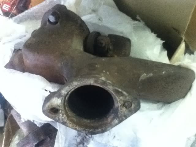

The manifold says H10 on the side
[IMG]http://i812.photobucket.com/albums/zz50/mollythemoggie/IMG_00881.jpg[/IMG]
alas it has one stud snapped off in one of the holes.. hmm easy out time at bunnings maybe?

Re: Exhaust Manifold to exhaust down pipe what size studs?
H10 is the Applied Model Code for B110 4-dr sedan (the original B110 of 1970). So that's good.
Exhaust Manifold
* 08213-82810 STUD FIXING EXHAUST MANIFOLD TO EXHAUST (2)
Get them from nissan, or take the manifold to Repco and let them match up some studs.
Posted on: 2011/7/4 7:33
If you ask Nissan for a Datsun 1200 stud, they will say "we don't have that anymore".
If you ask for part number 08213-82810, they say "sure, we can get that, they are 77 cents each".
