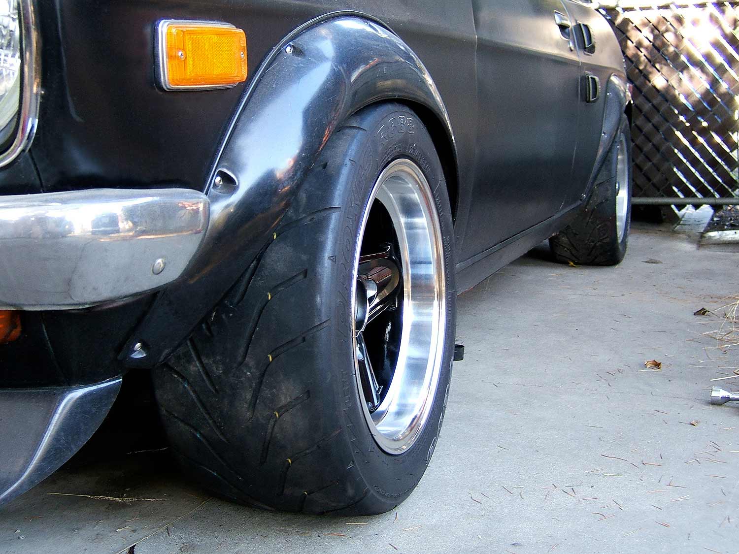

New wheels for the Coupe! I loved the Libres but they were 13x7's and the tires seemed to want 8's sooo.....

Does it handle different?

Only got the one mounted this afternoon... I need some longer wheel studs for the front because I need a small 1/8" spacer so the tire doesn't rub the strut.

sick wheels

that stance is tough as!
theres nothing like flares when they are filled out properly! especially on a coupe
whats the tyre width?
