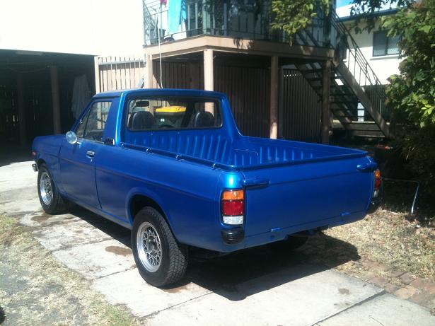

cool thanks well im transporting 2 dogs, my tool's and a few other small things...
its not low either so should be ok
