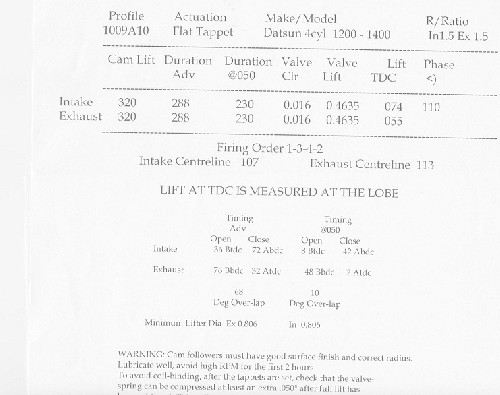

My new blown cam spec's
2011/1/31 2:06
From melbourne
Posts: 805
Running an A14 with efi and new gen 5 eaton sc. Hoping to get close to 100rwhp!!
jpg  cam specs.jpg (122.83 KB)

That looks like a Wade sheet?

Sure is Chris. Kicks in about 2800rpm to 6800.
