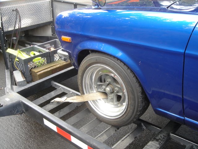

For securing to a trailer? I put the straps through the wheels
or use factory Tow Hooks
