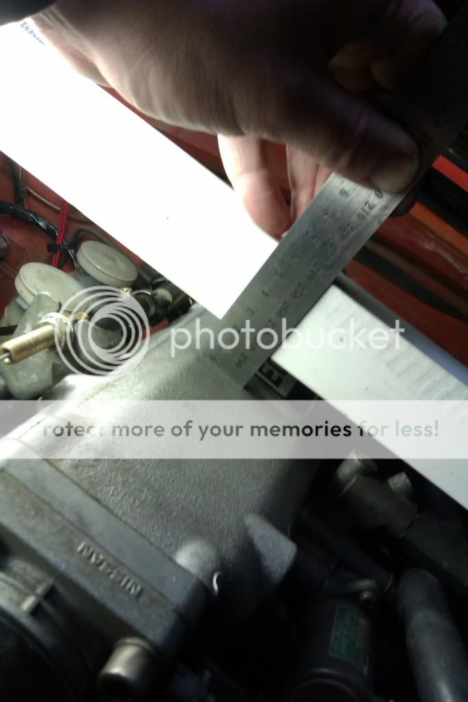

Just measured the height of my CA, probably pretty high
Put a straight edge across the top of the gaurds (in line with suspension tops) and then dropped a ruler down to the plenum
measured 19mm on mine
wondering if other people can do the measurement to see how other install compare
i used a custom crossmember which loosely resembles the Maddat one, main difference being the motor is further forward

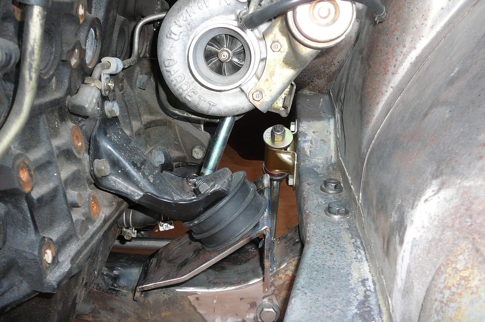

my off the standard member 12mm, back of firewall 25mm, what mounts your using..Open in new window
