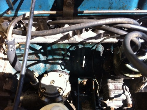

Car is: 1971 Datsun Sedan. Car motor is stock from dealer and been told its a A12, did they come stock from the dealer as a A12 & where do I look on the motor for this info?
Ive attached (I think) a photo taken of the oil leak,

Yes that's where the 1200 got its name, from the 1200cc engine.
It looks like it *might* have some oil seepage from the head gasket, which somtimes happens. Or it might be oil run down and around from the valve cover gasket. The "overall" kit is for changing the valves seals. Sometimes the kit is less expensive than the 3 gaskets however.
1. Re-torque the head bolts and see if it clears up. This should be done every two year in any case. The valve cover gasket can usually be reused unless it has the cork type.
2. If you decide to change the head gasket, You don't need a top end overall kit. Just the head, manifold and (maybe) the valve cover gasket. Any auto parts store will carry these.

Or to put it another way, the kit is a REGRIND kit. Just to change head gasket the valve grind kit is overkill
11042-H3927 KIT-GASKET VALVE REGRIND A12
VALVE REGRIND gaseket it is also called "HEAD SET" -- see Head Set for A12
