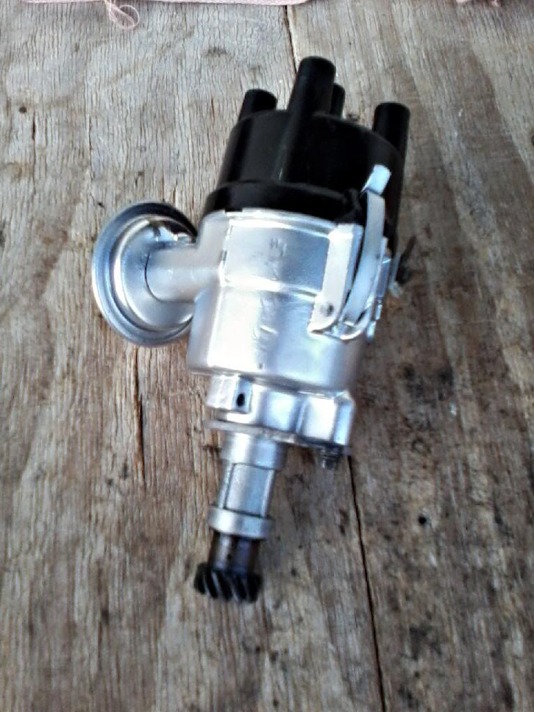

yes thanks,heres a pic of it thanks for your help

Re: A15 Electronic Ignition conversion.
how are you going to bolt it down?
make a bracket?
or, grind the distributor housing to fit the A14/A15 plate?
or just use vice-grips?
