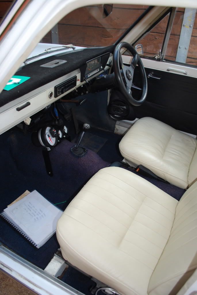

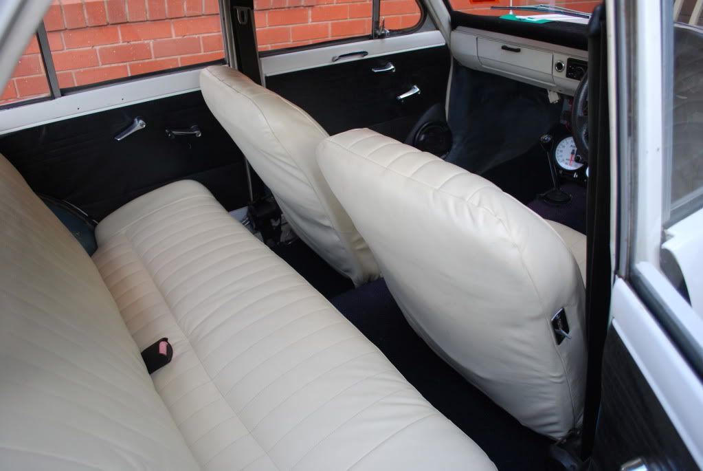

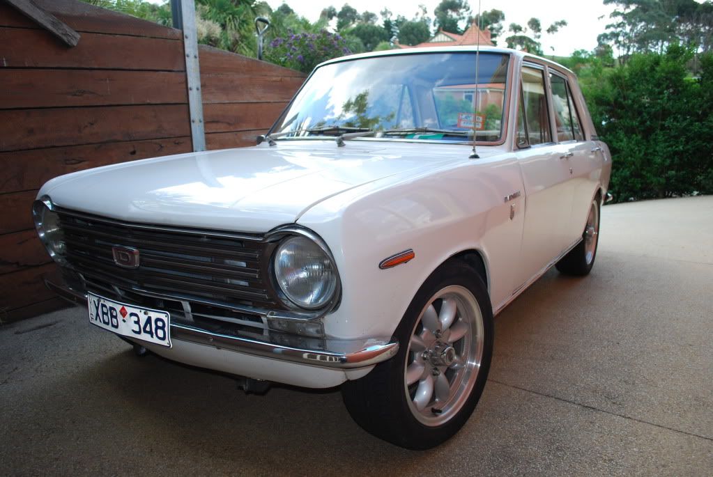

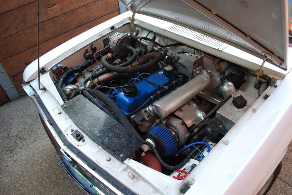

this is it when i bought it, not much has changed apart from a few little bits to neaten up the engine bay.
http://i303.photobucket.com/albums/nn121/ruffin101/DSC_0006.jpg
http://i303.photobucket.com/albums/nn121/ruffin101/DSC_0005.jpg
http://i303.photobucket.com/albums/nn121/ruffin101/DSC_0003.jpg
http://i303.photobucket.com/albums/nn121/ruffin101/DSC_0001.jpg

http://i303.photobucket.com/albums/nn ... F739EAEAA_zpscb871cb6.jpg
the engine now with new vaccume lines and gas line, and painted piping.

nice Thou... it's pretty full in there... :)
