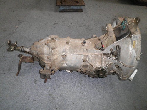

Maddat IRS hands down,
But midmounted A series using fwd only lsd Subaru box/diff
would be my choice for a 1200 ute or L28 for LWB ute.
http://datsun1200.com/modules/newbb/v ... ASC&type=&mode=0&start=20
jpg  zzz subey box fwd.JPG (54.35 KB)

Geez you have some stupid ideas??
Dude asks a simple question about rear suspension setup and you suggest mid mounting an A-series engine with Frankenstein drivetrain?
What the hell have you been smoking???
Dude, get your leaf springs reset by a professional, if they reset them too far they will not have any spring left in them and it will drive and launch like ass, get the extra lows by using small lowering blocks. Replace all the bushes and fit new shock absorbers.
That's what mine has, it handles fine, you dont have to butcher your car and it wont cost a fortune.
