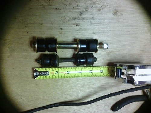

I bought a set of these off eBay
I was told they would fit a 1200 but they seem about an 1" taller than the stock sway bar links. I don't think this will work well as it might change the geometry of the sway bar?
Anyone run into this issue as well?

Pic
jpg  $(KGrHqIOKjwE3QmcNN5QBN8H+iMjog~~_35.jpg (9.31 KB)
13419_52646a95bb8b5.jpg 300X299 px

Re: aftermarket sway bar link assembly too tall?
2002/8/6 2:24
From Brisbane, Australia
Posts: 3792
easily fixed - cut down the sleeve to suit, and use a shorter bolt if neccesary.
2010/6/2 13:35
Posts: 2341
I think the discrepancy is in the sleeve. I think you are right though Harry. If I cut down the sleeve to match the standard height it should be okay. Good thinking.
2008/6/15 9:11
Posts: 4504
Yeah I did the same thing years back I cut the sleeve and was good
2010/6/2 13:35
Posts: 2341
After further examination it is not the sleeve.
It appears the bushings are too big? Am I being too paranoid?
jpg  bushings2.jpg (128.71 KB)
13419_5265d8107245f.jpg 648X486 px
Posted on: 2013/10/22 2:42
