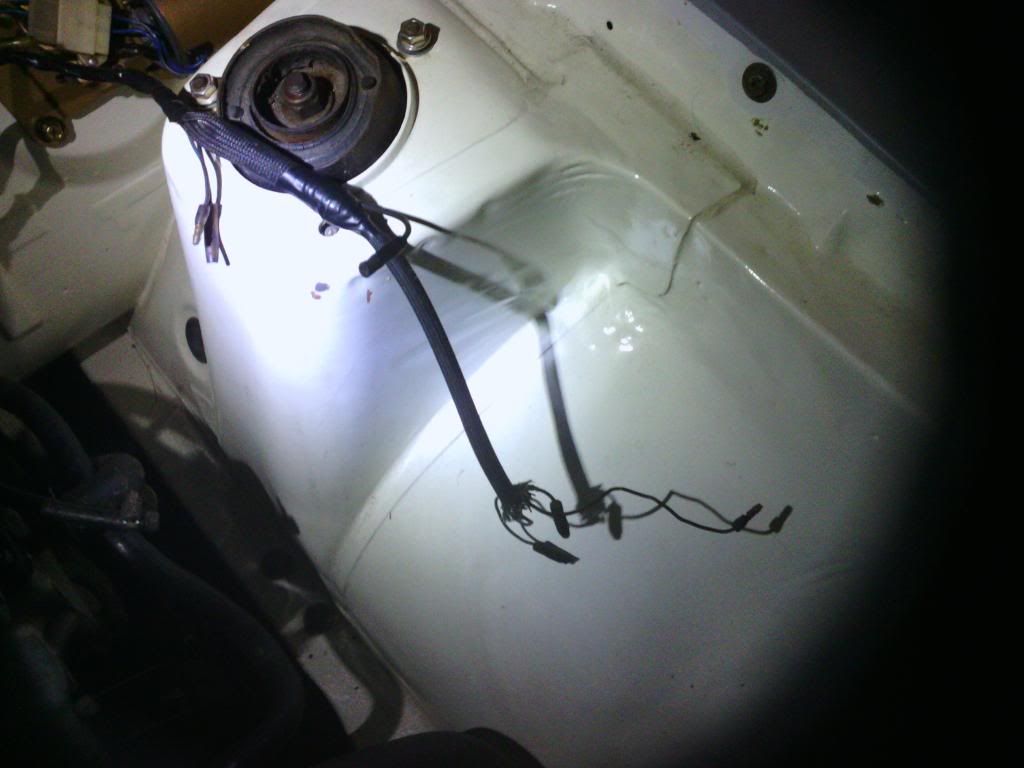

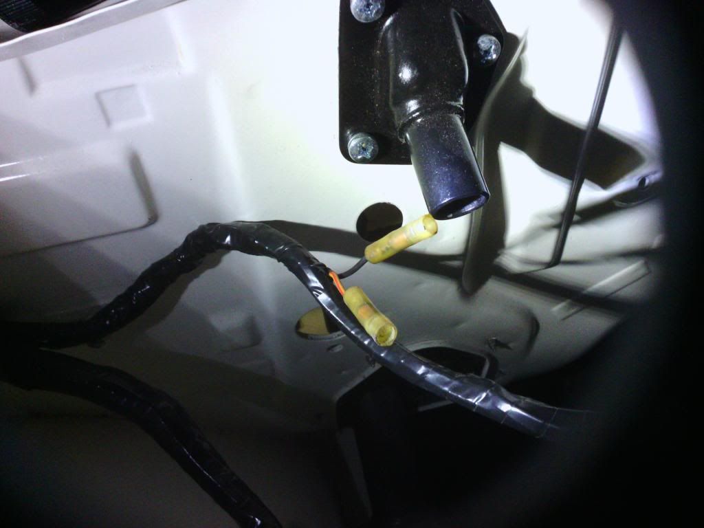

2) Unidentified wires not in wiring diagram - near clutch cable inlet - Yellow/red and Black wires

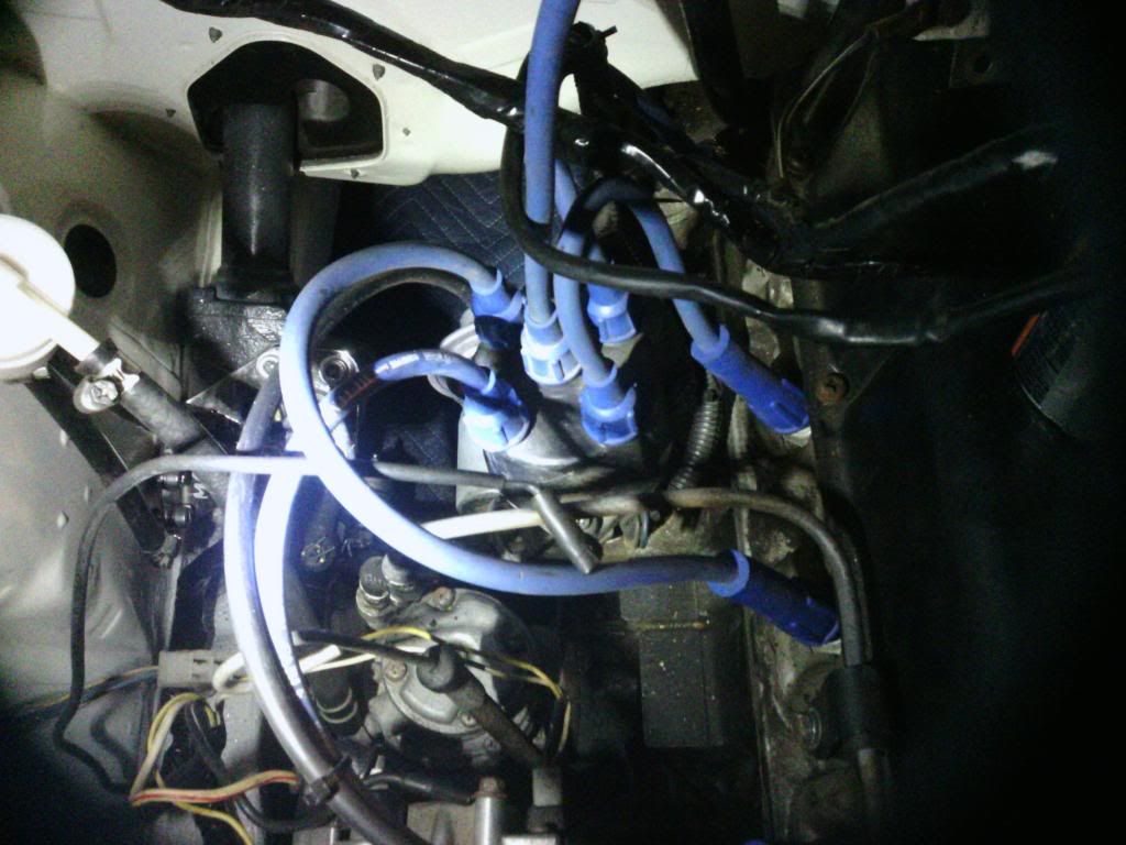

3) Black wire near #2 spark plug in photo... says "to distributor" ?(Number 16 in diagram) Connects to what?
Mine are not connected either.
[i]3) Black wire near #2 spark plug in photo... says "to distributor" ?(Number 16 in diagram) Connects to what?
You should have a connection at the back of your distributor coming from the seam between the cap and the metal body.

Thanks. I forgot to mention I have an electronic distributor so maybe thats why I couldn't find the connection??

Really confused as to where the black wire goes to on the distributor?

More than likely the wire near the dissy is an earth connection. Some dissy's had a spade terminal attached to the vaccum advance canister. Not really necessary as there is already an earth connection going back to the coil in the wiring of the electronic dissy.
The wires in photo no2 are probably for the wiring on the brake master cylinder reservoirs for a low level warning.
looks to be bullet connections like they use.
