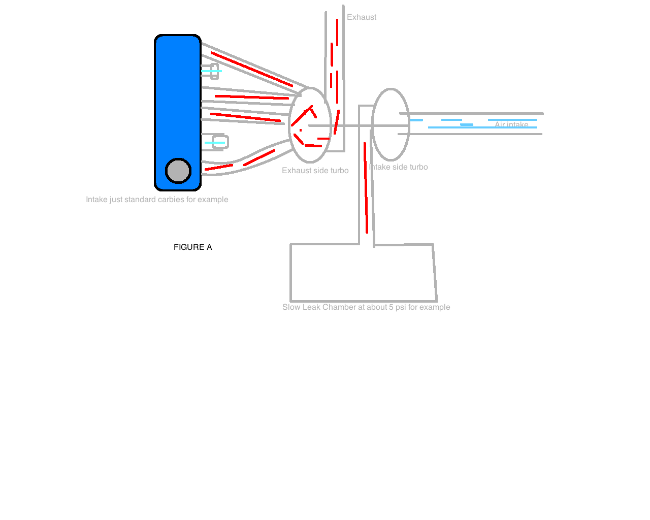

Cool ok see that's what I mean, for example if you had an engine set up with an exhaust going into a turbo, and had that turbo's engine compressing air into 'a slow leak air chamber' at say 5 psi for the heck of an example, the engine would still have to 'push' the turbine blades of the exhaust side in order to compress air on the intake side into that chamber. So this means that the engine has to 'push' and that is a restriction of flow, meaning it wasn't just free energy because the cylinders had to use a bit of energy to 'push' the air out of the combust chamber and through the headers into the exhaust turbine with enough power to compress air on the other side. I just drew up some pictures in paint if no one gets what I mean???

See in this picture the engine would have to work to compress that chamber

And then as you see in this picture the engine would still have to 'push' (which uses energy, so it's not free wasted energy cause the source of energy comes from the cylinder pushing the air out which that power is originally taken from combustion) the exhaust gas through the turbine to make compression on the other side.
I'm sorry if this is annoying to anyone, I'm just a 20 year old kid trying to get my head around a few things, and this never made sense when people said that it's 'wasted energy', it doesn't seem like it is wasted energy as the source goes back to the combustion for power, obviously...??
Am I missing something??????????????

You're looking at it wrong.
It isn't the flowof the exhuast gases that spins the turbo. When an engine expels the spend gases, the combustion event can be only milliseconds ago. The (very hot) gasses which are exiting the engine and passing through the turbo are still expanding. So it is more the residual thermal expansion energy of the gasses which the turbo is recycling, rather than the exhaust gas flow. I refer to this energy as residualas the initial thermal expansion at the point of combustion is what pushes the piston down the bore to make the engine run in the first place.
The turbo is more efficient because it harnesses the otherwise wasted energy. (VS the belt driver blower's parasitic losses to drive)
The difference is that with their being no lag, the supercharger has the scope to generate substantial bottom end torque.
