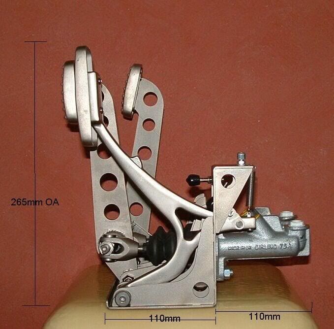

One I fitted to a racecar a few years ago
Much better quality though
Wilwood ones are alot deeper...more like 160mm + master lengths
So need very short legs ,st back seat , or cut holes in firewall to fit.
