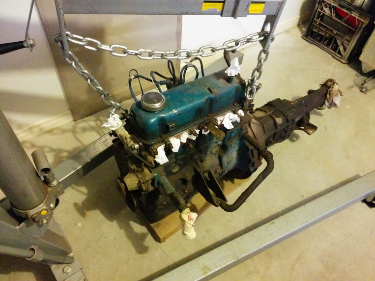

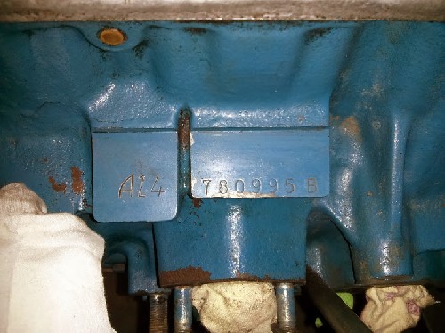

With the engine out we thought we would look at painting the block and replacing all the gaskets and seals just to be sure as it is a a lot easier doing this out. I also replaced the clutch with a new one. One thing I did find is that a A12 gasket set is completely different from an A14 set (my fault when ordering).
jpg  Datto engine.jpg (110.79 KB)
17641_53c635b35c6d7.jpg 763X572 px
jpg  Datto engine 2.jpg (76.84 KB)
17641_53c635ddd34e9.jpg 429X572 px
jpg  Datto engine 3.jpg (110.96 KB)
17641_53c6361c81a5f.jpg 763X572 px

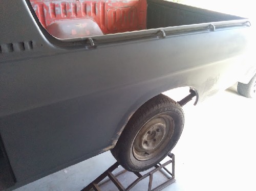

With the car now clean, I started the rust repair work around where the bumper bolted up on the drivers side. I ended up having to cut out a section around 25cm x 12cm from inside the wheel arch and welded in a new formed sheet section. I welded in two new nut lugs as the old ones were stripped so everything would be nice and secure. We were pretty lucky as there was little rust anywhere else and it looked like the previous owner had fixed some other parts in the past (tray to cabin sill).
jpg  rust.jpg (60.10 KB)
17641_53c6fef43eb49.jpg 400X534 px
jpg  rust repaired.jpg (118.48 KB)
17641_53c6ff06306aa.jpg 769X577 px
