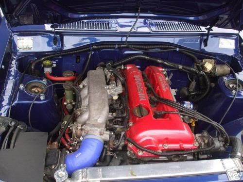

Pic of Proof

Surely this is not engineered ? Standard master cylinder and no sign of booster - not something I would want to drive ......
