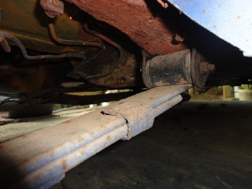

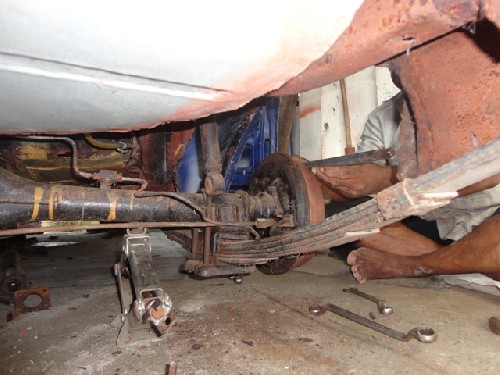

Here are some snaps taken out , look at the Spring Moved Back image when i jack up the spring
Spring Eey Moves Back , even if i put it with the suckle it self it is going backward up like this
so the wheel position comes to the rear side more ,
any body can give me lenght of Leafsprings exactly ?

B210 leaf spring is 1165 mm long.
6-leaf spring pack is from a commercial vehicle or older car. Sedan should only have 4 leafs. Does the other side match it?
