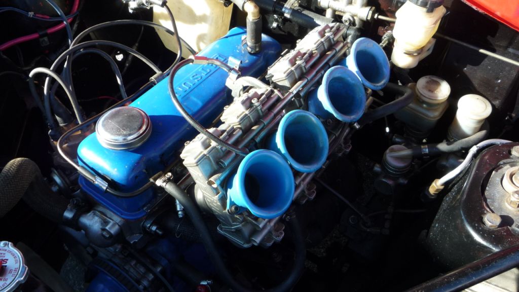

D First I put a picture of the engine bay in the track photos, see below.

What are those carbs off? Looks the business.

Those are Keihen FCR carburetors. You can buy them from various motorsport shops.
Keihin is a major suppler to Honda and supplies Triumph, Suzuki, Kawasaki, KTM, and Harley-Davidson. Keihin’s largest shareholder is Honda Motor Co. Ltd.
