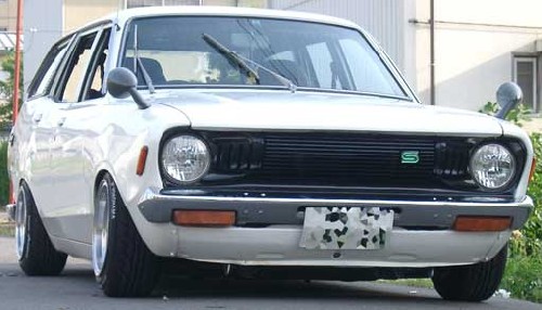

Hi Guys
Datsun became live again after the accident repair,according to the ladies earlier it had a smiley face now it is having a angry face ha ha ....
I have a small problem while hard breaking it makes a grinding noise , i checked it and found the tire is touching right fender(please refer Image No 3) it doesn't happen on driving or turning or normal breaking but only when breaking hard ,any one has an idea what courses it ? what should be checked first ?

Re: It was a Bad Day
2015/2/14 5:47
From Sydney
Posts: 57
Taking into consideration where most of the damage is located, have you checked your suspension after the accident? It would seem as though the wheel has been forced toward the back of the car..
2008/11/26 10:52
From Sri Lanka
Posts: 1232
Hi
to the eye there is no sign of that ,i am worried why only when hard breaking it happens ? if not it is good no noise no problem or wobble in driving too,
2002/3/20 3:40
From Melbourne, Australia
Posts: 8221
Castor rods are the main thing that prevent the wheel moving back under braking. Check it first
