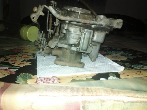

Hi Guys
As i had a idle problem in my carb ,i am in a need to replace it , i checked my b310 carb to b210 it works well so i think my b210 carburetor needs replacing now.
i got a carburator from friend of mine for free, i went and pulled it from the engine , it is a datsun engine from its upper cover i dont know what model is that engine, did not have time to check it becs it was late evening,
Carb Says AISAN and has casting no 2J20 and there is another id plate just fixed to the upper cover it says C28AB
bolt pattern is little wider than mine i need to to have a adapter of kind of thing to fix this , has anyboday used similer to this on their datsun ?
and do datsun have these kind of carbs ? in wich models ?
thanks
regards
sumith

Just Learnt from another forum 2J20 means
it is 1972 model j means it is manufactured on october month manufacture on 20th day
so it is clear this carb must have been a stock for a car which came between 1973 -1974

Re: Any Body Knows which model datsun has this carburator ?
Aisan is used by Toyotas, but it may fit on A12 engine
See 23717

great, do you have a close image of the adapter to be fitted to the manifold because bolt pattern is little wider on this than a12 manifold i want to make something to fit it
thanks
regards
sumith
Posted on: 2017/8/14 9:29
As I understand, there is no adapter. The particular model of Aisan carburetor is 23717 uses the same bolt pattern as the A12 Hitachi carburetor
It seems the Aisan you have is a different model?

For me it is like having a adapter because carb is little higher from manifold and i can see some nut and bolt between them, any way i need a adapter for mine,
Strangely it was fixed on to a datsun engine its rocker cover almost the same to A12, it doid not have any adapter there,
I was dissembling the carb to clean , there is no big deal straight forward unless one section of it , do you have any idea what this section for ,what it does ? please refer the images

I do not know, I have never disassembled an Aisan

From my auto shop i found that this carburetor is a model of toyota KE 30, 35 and 40, and found a repair kit for it fixed it back only i have one issue in that Power Piston is not moving it is stuck there is no way that i can replace it cant take it away also, power valve works put power piston does not move up and down it is stuck in the down position, what will be the impact on the car if i fix this like this will it work ? what problem will i have over it ?
please share your suggestion
thanks
regards
sumith
Posted on: 2017/8/28 5:37
Power Valve piston stuck in down position will make it run overly rich (except at full throttle, when it is supposed to be down)
