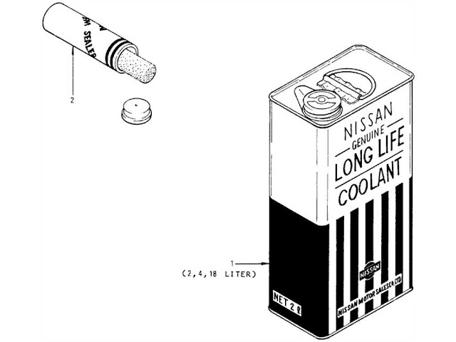

Part Numbers
USA
SBNLL-C0001 COOLANT-NISSAN LONG LIFE 2 LITTER(0.4
SBNLL-C0002 COOLANT-NISSAN LONG LIFE 4 LITTER(0.8
SBNLL-C0003 COOLANT-NISSAN LONG LIFE 18LITTER(3.9
10125-62200 N.C.S. SEALER (1 CARTON-96
