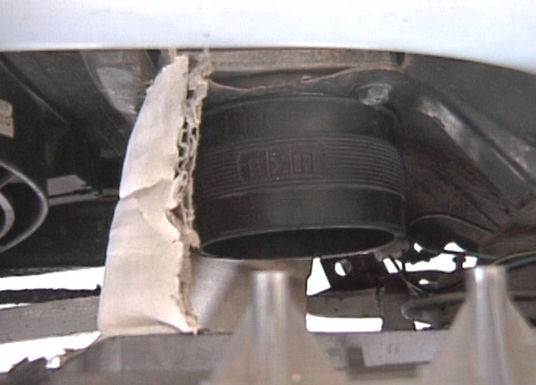

for the sake of cold air indution I had the AFM put there  but the electric fan for the radiator sucked air back out of the airflow meter so I put a cardboard barrier to stop this and idles nicely now

Do you have a filter??? I get a bit freaked out when no filters are used...

Filters reduce your cfm. They almost as bad as positive ventilation for your crankcase.
