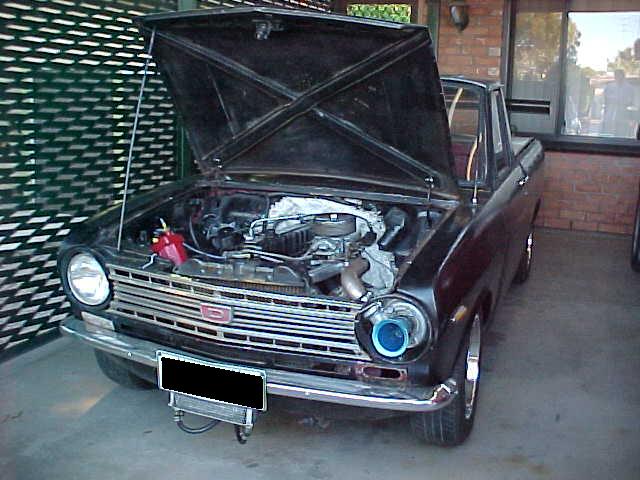

Not bad,ENGINE SPECS=
Engine: Holden 186 "S" (3.05 Lt) + 60thou 192ci
Head: Yella Terra
Crank: Steel
Pistons: Flat top
Induction: Centrifugal Blower, 350 Holley, RedLine Manifold
Cam: Crow
Ignition: Electronic Distrubutor With Accel Coil
Exhaust: Custom Length Extractors/ 2 1/2 Inch Pipe With Stainless Rice Cannon
=Power Output= This Motor In Standard Form Put Out 145hp, So Im Not Sure What It Would Have Now.=
=Gearbox= 3 speed Tri-matic With 3000 Stall Converter And VN Shifter
=Diff= 3.90:1 Banjo Locked, At The Moment It Is Standard Datsun Will Be Upgraded When The Axels Turn To Speggetti.
=After 5 Short Drives And Not Much Sideways Action The Stock Datsun Axel Let Go, The Night Before the Drags. So I went Out To The Drags With A Blown Axel, The Result= Full Track Wheel Spin And A Very Slow Time.=
=INSIDE=
Seat: Standard for now
Harness: 3 Point Race Harness
Guages: Tacho, Oil Pressure, Water Temp and Boost
Wheel: 10inch MOMO with Original Datsun Horn Button

is this yours peter????
that would rock, is there any particular reason the blower is mounted so far away??

What is all the alfoil for

there is a roast in there, should be well done by the end of a night at the drags

That horn out of the head light had me worried but it's all right now. Realised it's a bellmouth. You can't argue with tyre smoke
