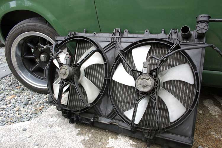

Pull this out of an N14 Pulsar at the local. Cost me a HUGE $68 with twin electric fans. I measured up a bunch of different radiators, most would fit width and thickness but maybe a little bit high so i stuck with this. Should fit well.

thanks all. i must have measured up about 5 or so different nissan radiators at the yard. A lot of them would have fit and many had twin fans but i chose this over all over them because it wud fit that much better (not as tall as the others).
I'll measure it up for you if you want.
I did indeed get the top and bottom rubber bushes and the top mounts but unfortunately the bottom mounts were welded to the body so i didnt get those.
Im stoked. What hoses wid you guys use? the standard ones? i didnt take them as im going to get new ones

for the top mounts a litle bit of a cut and a fold and they fit in to the radiator support panel like they were meant to, for the bottom get a couple bits of steel tube that the rubbers fit in nice and secure, weld a flat plate to the bottom and screw it down to the cross rail .... quick and easy install
as for hoses i managed with original bottom hose but cant remember what i went for on the top ?? just rember that it had to be longer thru the straight bit between the outlets ...

i read in an old photo thread thing of your boof that you used a bottom hose from a 120y cut in half ??? and the standard 1200 bottom one. that right ?

Im putting in a worked a15 and instead of trying to use the a12 radiator which would suck just went and found this.

they do fit well
boofhead runs the same rad in his sedan with worked a12
unfamilia runs the sr20 n14 version in his sedan with a15
i run an aftermarket version (30mm core instead of 16mm) of the sr20 rad in my ute with 12a engine.
made to fit!

What are the dimentions of this radiator?

great radiator and fantastic fit
just one thing chris, to make the install all the easier see if you can get the top and bottom original rubber donut mounts, including the steel bracket from the top mounts. makes it all the easier to mount and also gives it the proper vibration isolation they had in the pulsar
