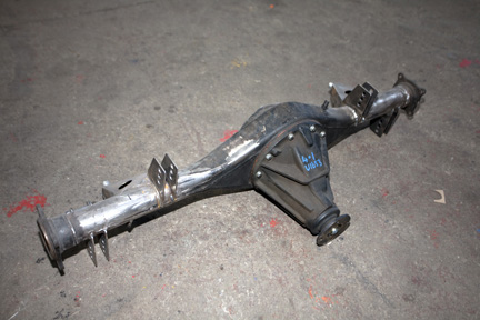

Hi Quinn. I have a Datsun 1200 wagon and i have a Hilux lsd in the rear. Im lookin into anit tramp rods and are those mounting brackets on the top for that???

I'd say that those are the mounting points for a 4-link setup, no tramp bars needed then. I had a moment where I though about doing that to my seadan but I'd have to have the shock tower enlarged to fit a spring

Yea this rear end it set up for four link and Watts linkage. If you wanted to set up an anti-tramp bar you could get a hanger bracket welded to the bottom of the leaf spring plate that bolts to the diff (for the rear bar mount) and get the front leaf hanger bracket extended to bolt the front of the bar to (hope this makes sense). I'd rose joint each end to keep friction down.

for pics of the setup quinn is explaining
see here
here
here
and here

Cheers for the pics pigdog, thats the setup I was trying to explain, nice work by the way.
