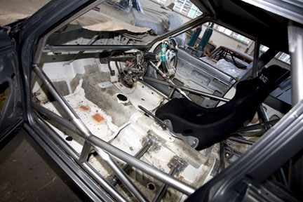

Building the cage.

Have they been checking clearance for the dash cluster etc, Ive left my underdash bar for now, cause im mounting the clutch and brake masters under there and dont want anything in the way.

 Re: cage progress
