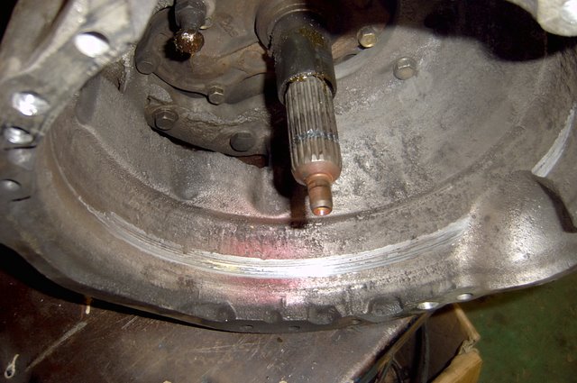

The plate ground a groove in the spigot, and also chew a groove around the bell. I suspected this bell  of being either of center, or not perfectly parallel when I first fit it.
