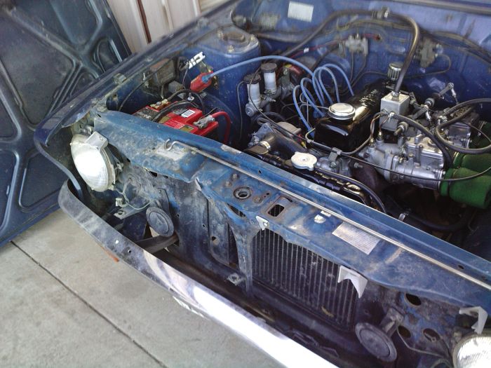

Not sure wat to do from here... do i get new panels and fix it or find a another 120y hmmm

I noticed the power brakes and that square thing above the webers. How does it work?

 Re: Dam Roo
its a little alloy chamber i welded up, kinda like a multi port vacum box it shares a little vac from each port instead of stealing all vac from one port it also makes the twin webers more smooth in low rpm, most stock twin carb manifolds have some sort of cross port chamber this manifold being after market(redline) does not.
heres a sightly better pic
edit: yes i ended up panel beatin it straight i put a large bit of rhs between the stut towers and jacked it back outwards while hammering out the creases. it came up a treat..

 Re: Dam Roo
yea i think the bumper bar did its job.. was doing bout 130 when i saw him, probley down to 60 when i hit him wasnt a big roo just medium size,he didnt go under or over but more and less got push alone for a while, now i get to laugh at him each time i drive by for a coupe of weeks or untill somthing gets hugry From wat i can see the gaurd and rail dont look bent or twisted at all, i guess by checking with tape measure u mean compairing left and right sides distance from firewall to front of gaurds?? question for u smash repairers out there wat would be the general way about fixing this?? drill out the welds and replace the top(mabey bottom aswell??) half of the rad support or just panel beat it straight, i want it looking 95% when finished not with crease's and dents. I am confident i could cut and replace presuming i can get new panels, but if its easy to take it to a smash repair place and get it panel beaten mabey ill do that depending on price of course..

 Re: Dam Roo
fuuck that sucks dude, was one of the straightest 120y coupes around!
Take a pic of the roo

 Re: Dam Roo
A-arm?? please explain.. yea not that big of a repair job just not sure weather i want put more money into this shell as it has some tricky areas that need rust repair, also all the seams have rust due to previous respray using incorrect sealer???

 Re: Dam Roo
The rail the guard bolts to, pretty sure its called a-arm. It does look a little tweaked, some hours with block and tackle and a tree/stobie pole would fix that.
I suppose 120ys are pretty easy to come across, depends on how handy you are I guess whether you should persist with it or move on.
Get out that measuring tape and see how bent it is.

 Re: Dam Roo
The damage doesn't look too bad considering a roo was involved. I've seen some pretty nasty roo hits before.

 Re: Dam Roo
Thats an easy fix. How bent is the a-arm?

 Re: Dam Roo
piece of piss,just pull it back out and blow some paint on,no need to replace anything,except the bonnet n grille.
