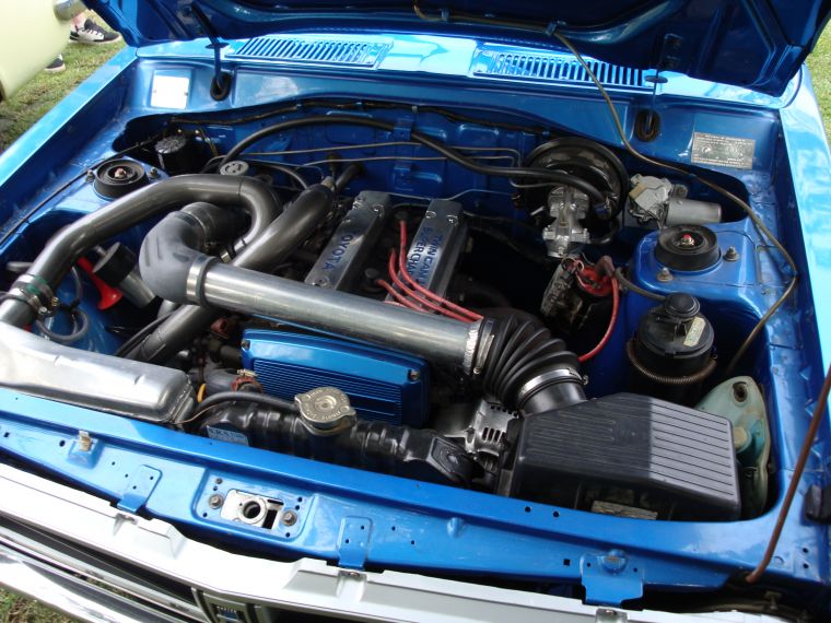

As the title states this is my 1200 ute with a 4agze in it with a T50 gearbox, it has a nevo pully kit to up the PSI to 14.

Looks like the stock radiator?
Had it dynoed? how much power does it put out?

Hey man your right about the radiator it is a standard 1200 one, and I have dynoed it, there is a video on youtube but it stuffed up so it’s not the full run but it made 113hp atw which isn’t massive but the torque is the best part about this conversion.

Looks really nice and tidy, but does the radiator keep up?
Hell, when I removed the mechanical fan from my A12 it struggled with an electric fan to hold the temp down in summer time.

 Re: Datsun 1200 ute 4agze
Hey man surprisingly it does work well, I have a hand held computer in my car and it is always running the right temp, I run a thermo fan pretty much runs all the time but I don't really want to change the radiator as it does the job.
