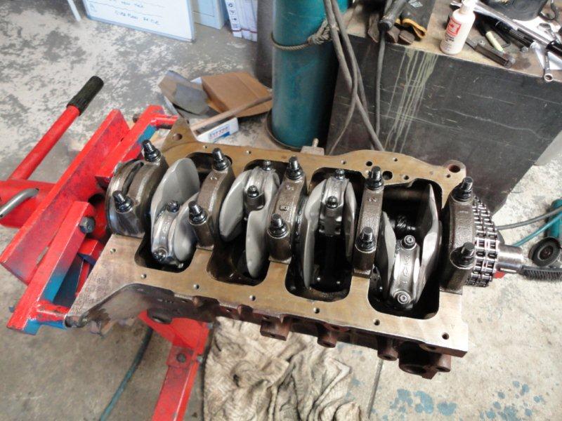

here is my new A14 crank with stud kit fitted.

sweet setup, pity knife edging requires so much effort
and other mods to keep the camshaft properly lubed
Posted: 2018/8/29 4:32  Updated: 2018/8/29 4:33
Joined: 2001/5/3
From: Kent, WA
Posts: 31832
 Re: New Crank with Stud Kit
Knife-edge crank shouldn't be a problem:
* Crank doesn't dip into the oil
* The camshaft is fully pressure-oiled including each lobe
Problems with premature cam wear are 1) improper break-in (no cam lube) 2) re-using lifters 3) improper cam or lifter re-facing
