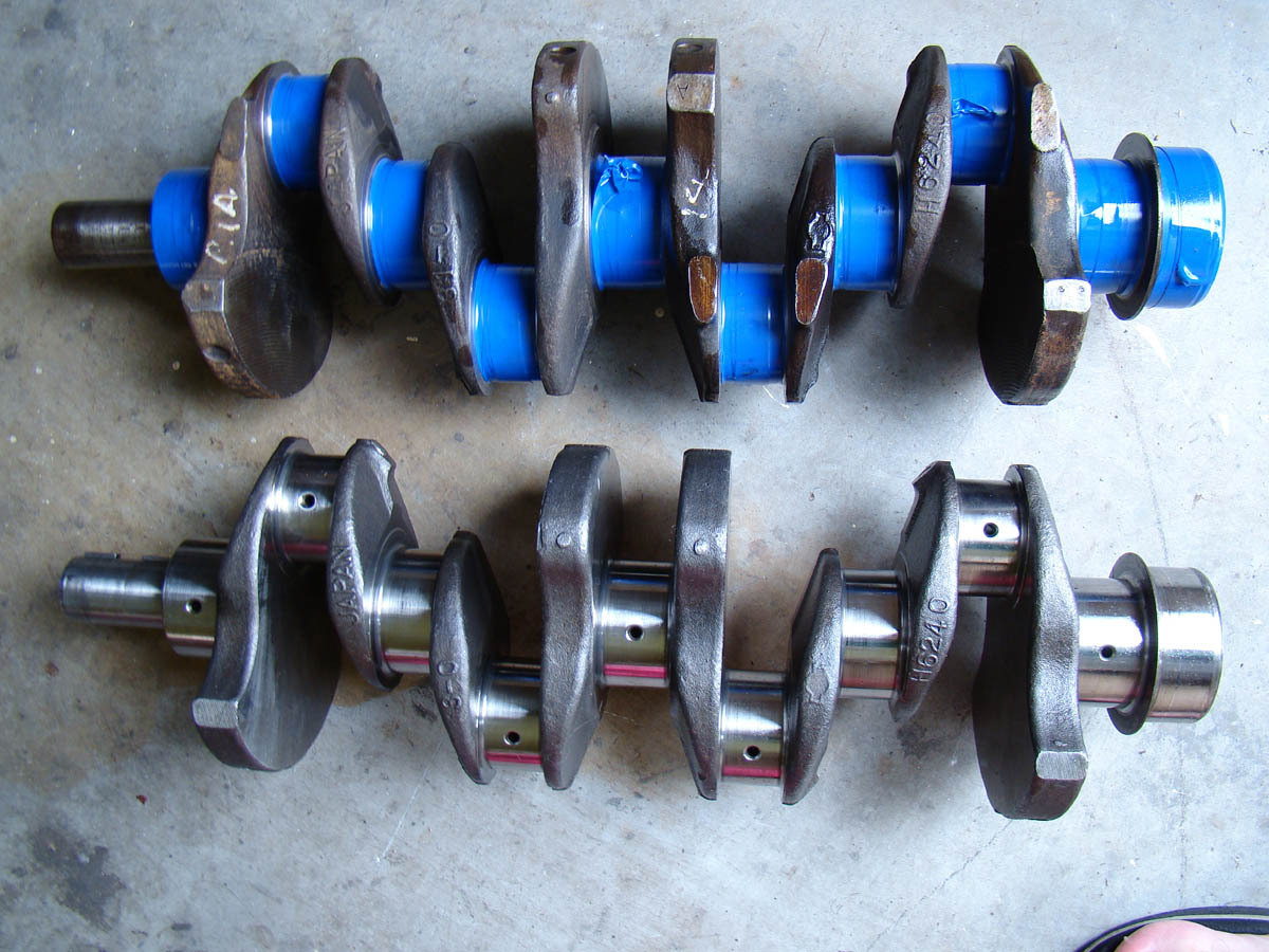

bonus points for telling me what's differnt between them beside the number

The blue one has been re-balanced for a new set of pistons & rods. I can see where they added slugs of heavy Mallory metal. It also looks like they ground away some spots of the counterweights, not sure why.
Both are the H6240 casting.
