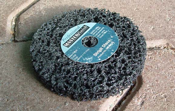

Best invention ever.
Melts through paint. Leaves the metal buffed kinda after it's finished. No scratch marks...

Have used these for yonks. Best used after paint stripping to get off excess paint and crap, Once its all dried out of course. Or on very faded/thin paint.

I am with u on that lobster they are fanbloodytastic and dont block up with 2 pac woooohooooo

yeah they work good till u use it for a while and it starts throwing bits of wire with gunk all over it at ur eyes.

I love using those too but the discs I buy tend to break down on me rather quickly. I don't let them cool down much
