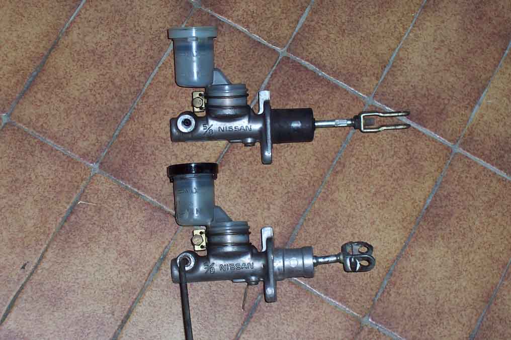

gotta copy that bottom pushrod to the top one, can i just unbolt the bottom one and put it in the top one?

doesn't it just have a circlip holding the push rod in against the piston ??
if so then yes they should interchange

yeh thanx for that swapped em over.. tho gotta chop up the silvia pushrod up now and weld a new bit on the end so i can adjust it more... gotta h8 custom stuff ay

why don't you just add more thread to the rod with a die nut?

yes
