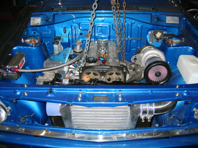

the eng bay is almost complete

Normo: also the w50 box just fitted so while it was bolted to the motor I makred the tunnell where it was close (at the back near the gear stick area) took the box out and gently pushed the tunnell out with a little hammer

lookn good mate jez u dont waste any time.
i wreckon the filter would be be more efficient out near the cooler getn fresh COLD air,
just my opinion. Thats what i have done, fill us in with more shots in near future,

DVLDAT: its just sitting on there at the moment I'll make 2 intakes for it 1 will go to where the headlight(for the drags) is and the other will go to the front of the eng bay(for the street)
Normo:I made the manifold my self out of 11/4" steam pipe and I'm running a W50 celica box with a 20rg bellhousing with 5mm machined off the back where the box bolts up to it and a 12mm adaptor plate to bolt the bellhousing to the motor, that I made myself also... I've posted up the picks as well if you have a look they should be some where there
