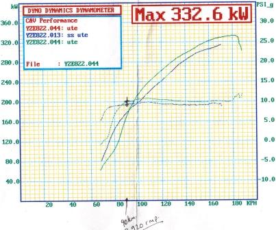

This graph shows the result of running water injection pre-supercharger. It's ineresting to note that Harrop who manufactured the supercharger and Pulley, rate this set-up as a 9psi kit - their own car is making 9psi. With the water injection, it now makes 10psi.
Two theories on why this happens....
1. Colder air is more dense.
2. The water actually helps the supercharger "seal" internally making it more efficient and minimising tolerences during the compression stage.
