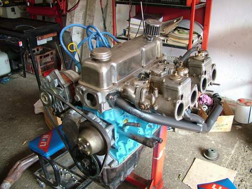

My 14

it is a nice clean lookin motor. I dont know but is that to much carbby? My weer 32/36 always felt like it dumped way to much fuel on a good flogging

very very nice I love the whole appearance of it, did you buy the extractors from Datrats? are the carbs weber DCOE 40's? let me know how the extractors go

She goes pretty good have had a few races with it. Its the one i have in the bluey (mukes old car)
This the one i was selling a while ago but I just couldnt part with it. Is become part of me.

hahaha yeah this engine will not like going down a straight pulling 8700rpm and slipping a gear, something tells me it will blow up
Yeah there 40s.

Yeh I blew it up at calder a year & a half ago. Not buy reving it to hard,cos I farked up with setting up my big end clearances up cos I was in a hurry to get to the race track. I geuss the only time you should be in a hurry with a race car is on the race track. But I learned that the hard way. Well that was a 3000 buck mistake & a couple of hundred for a new helmat that I threw in to the ground when it happend in frustration.
R.I P A14.
But all is not lost.
It is now A15 better pistons & bigger cam shaft ect. Should make more H.P. I was selling it a while ago but no body wants to pay what its worth so I will hang on to it. You will hear about the new project soon.

looks great!! should sound and run great
your headers look like they're damn close to the webers, with a little header wrap even just around the lower weber mount screw should save you from having to replace the bottom dcoe rubber mount. once it perishes from heat u get airleaks and de-tunification occurs. goodluck & enjoy when its in your datto!
polished rocker cover looks great next to the webers!!
