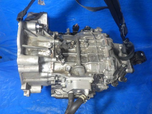

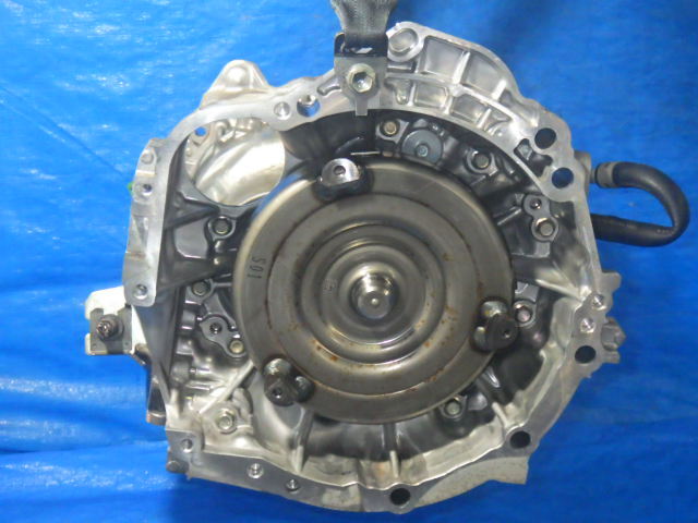

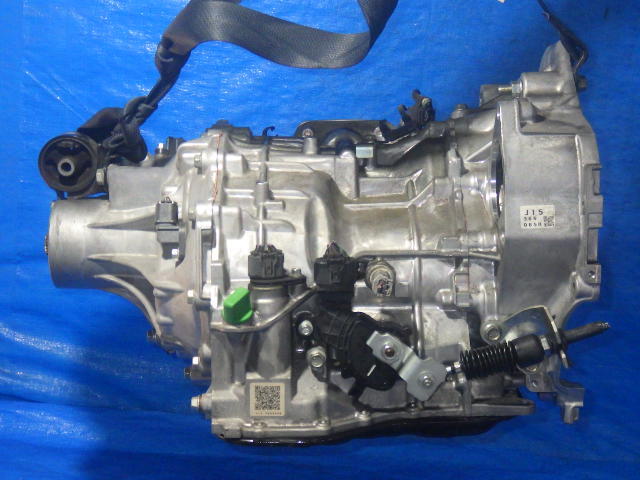

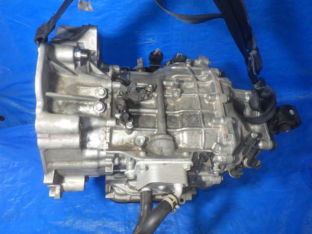

* hook up the automatic coolant lines on the left side
* adapter plate between gearbox and engine
* custom tailshaft
* modify 1200 automatic shifter for cable
* fabricate flexplate to fit
* can you use the ECU from the van, or does it work without
Only $150 opening bid. Toyota Pixis/Subaru Sambar/Daihatsu Hijet
2022 Hijet Cargo S700V KF-VE4 CVT Automatic Transmission
