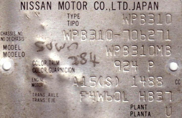

The picture below shows the data plate from a B310 wagon & I think that a similar tag was used all over the world.
The two lines of info that you want to see are the second from the bottom, where it says....
Engine A15[S] (carb equiped A15) & the bottom line where it says...
Trans. Axle. The code HB is the second version of the H150 differential & the number 37 says it has a 3.7 to 1 ratio
HA39, or HB39 would be H150 diffs in 3.9 to 1 ratio.
It's all too easy thanks to Feral & his boundless technical knowledge.
In the first line [Type] the code breaks down as W= wagon & P= A15 engine.
In the third line [Model] the second last character 'M' is the code for Australian models. I have no idea what the last character 'B' indicates.
