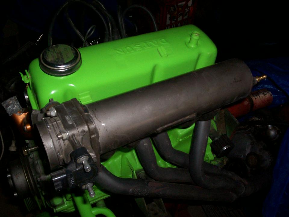

Re: a12 efi setup
2004/8/29 4:24
From south australia
Posts: 1532
here you go heres mine
Posted on: 2006/9/29 11:38
Re: a12 efi setup
2005/8/8 9:38
From The garage, NZ
Posts: 1922
thats a pretty sweet little setup you have rb. can you ellaborate on what parts and work you've used and done?
Cheers
Posted on: 2006/9/29 21:26
Re: a12 efi setup
2004/8/29 4:24
Posts: 1532
as you can see the plennum is all custom made. I think the throttel body is eiter rb30 or ca18 i am not sure fuel rail is custom,and the injectors
are VL commadore as is the fule pump. an it is all run by a wolf 3D
i am buying my mig welder next weekso i can get rid of the supercharge and build me a turbo maifold schweeet!!!!1
