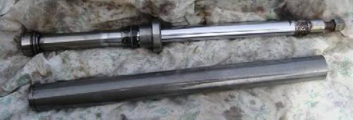

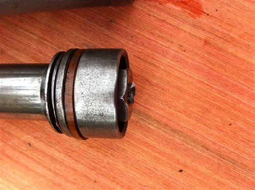

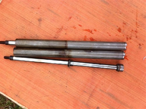

I found some sunny oil filled shocks that should fit the larger strut size. Why were people so quick to get rid of these in favor of gas filled ones?
Is it that the valving is crap on compression and rebound or you can't get seals for them anymore?
All good shocks (Bilstein, Koni) use oil.

Those are strut pieces, guts. There were replaced by insert cartridges starting in the 1970s, meaning that they were no longer rebuildable
Quality cartridges are available in oil or gas-over-oil
