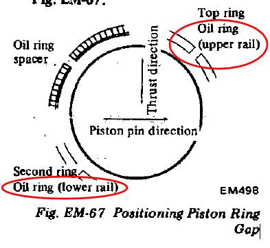

also with the ring placement, when it comes to the oil spacer ring where do the top and bottom ring go for that? ive read somewhere 15 degrees either side of the oil spacer gap.
as you can see with the image, the 1st and 2nd ring are 180 degrees from each other and the oil spacer ring is 90 from either one. so where do the other 2 rings go that are with the oil spacer ring?

in the image above is that saying the compression ring and oil ring are in the same positions? that diagram is out of a b310 A15 FSM which is the engine i have.

The "oil ring" is three pieces:
* Oil ring top rail
* Oil ring spacer
* Oil ring bottom rail
That Nissan FSM has a circa 1980 recommendation. Your ring manufacturer may have a slightly different suggestion. Either way will be correct

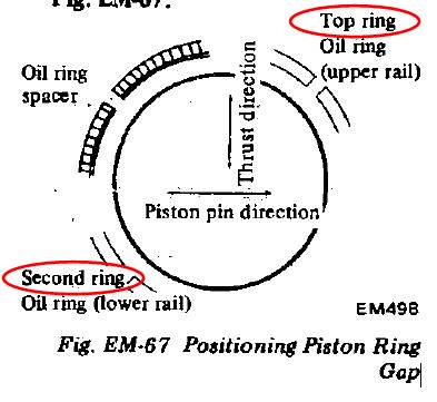

so where do the compression rings go then?

Good question, that diagram could be better
The compression rings are the Top ring and the 2nd ring. Nissan recommended lining up the Oil ring rails gaps with the compression ring gaps

Perfect that's what I thought. The diagram could definitely be labelled better. Thanks again for your help DD
