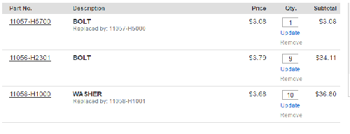

Would these be the head bolts and washers I need for an a15?

You can get all that for $10 at pick-n-part
The part numbers are shown in the Nissan links given earlier
