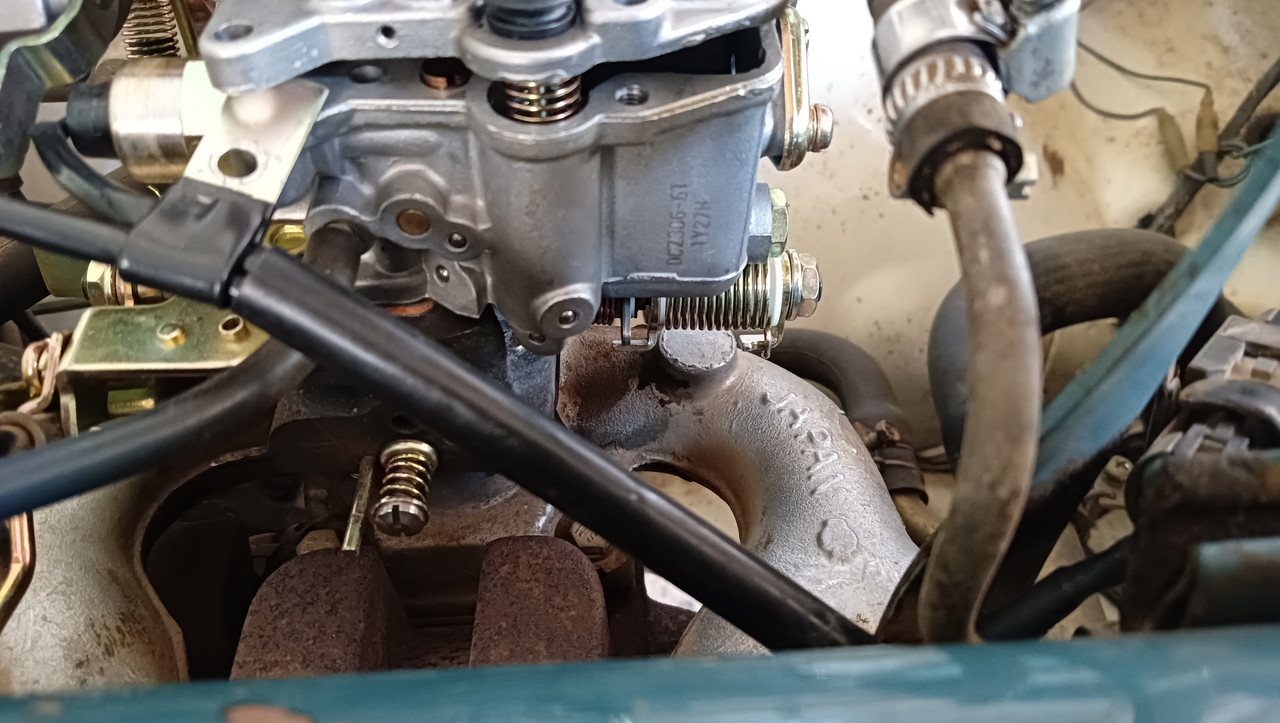

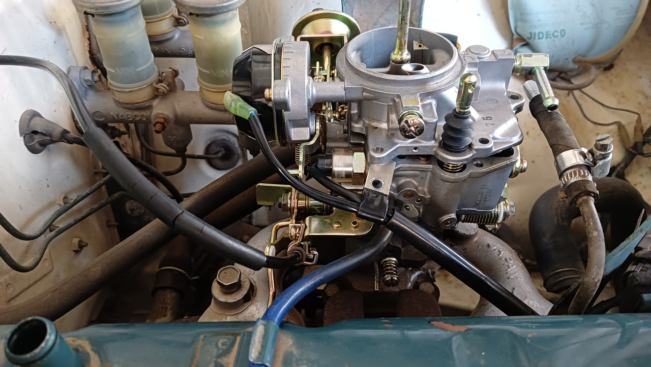

Thank you so much for the replay.My carb is more simple than the one in the pic you posted.I will upload a few pics at the end of the post.Well i will try to describe a little better how the car runs.It starts perfect when it is bone cold,idling fine,auto choke works fine.It will hesitate some when cold but after it warms up a bit,it runs a lot better.When it comes to normal temperature,it runs perfect,litteraly perfect.Only issue is that it hesitates when it is cold,i assume it has small low main jet,i didn't check it but i will.

Althought my car don't have this feauture,the winter-summer function,you might nailed it.Temperature is even lower,yesterday was -6 Celcius with a lot of moisture.If i open the hood,the engine bay is really wet like someone pour water on it..Only early in the morning when the car sits overnight under extreme moisture gives me trouble.In the afternoon,when i return from work,again with low temperature it runs like a clock.I believe there is something related with the moisture,mabye a bad coil?I will replace the coil since these are fairly cheap and i will see.Something else i am not sure about is the timing,i have many years to check it and i still run the points.First thing next week is to buy an electronic module along with an ignition timing pistol detector just to be sure about the timing.
I will report when i will have news.
