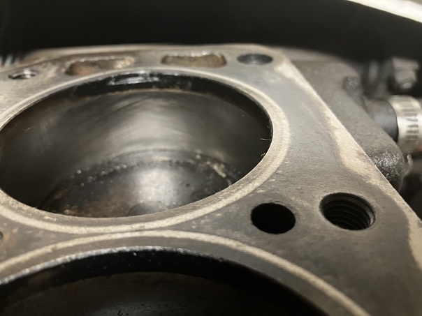

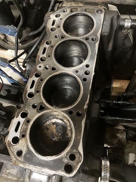

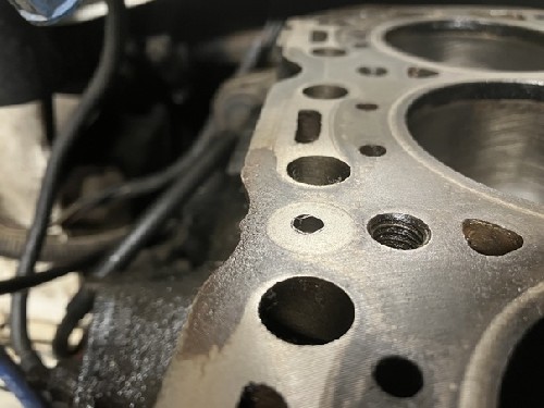

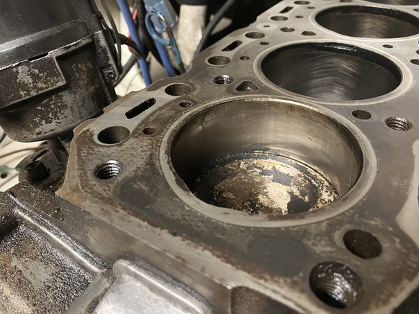

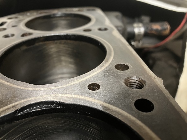

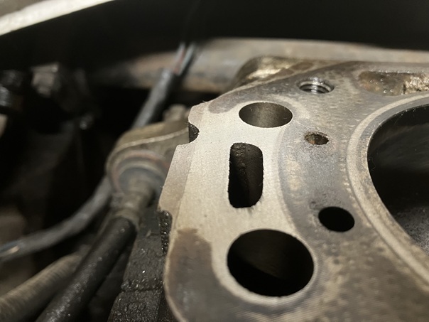

Hi guys,
I'm fitting a reconditioned H89 head to my A12. Question is, how far should I go in cleaning the engine deck? See pictures attached of deck. So far, all I have done is cleaned the old gasket with a razor blade. Deck surface is completely smooth to the touch but there is obviously still a lot of staining still present. Engine was running well with good even compression on all cylinders but all the head bolts on manifold side had some corrosion on the bolt thread indicating some coolant leak from water passages. Head bolts on pushrod side were all clean without corrosion. Deck flatness is good.
I feel there is a need to clean deck further but not sure the best way. There are a lot of different opinions around. My instinct is to use a lapping plate backed with 80 grit sandpaper to get back to shiny metal. I'm a little concerned with debris entering oil/coolant passages though. Particularly hard bits of sandpaper grit. Can I limit grit contamination using some wd40 or similar to hold on to grit a little? Or some other technique completely?
Thanks.

yes it needs a bit more cleaning. Use a gasket scraper and ether spray. It doesn't need to go to shiny bare metal, but you'll be able to remove all the gasket material
